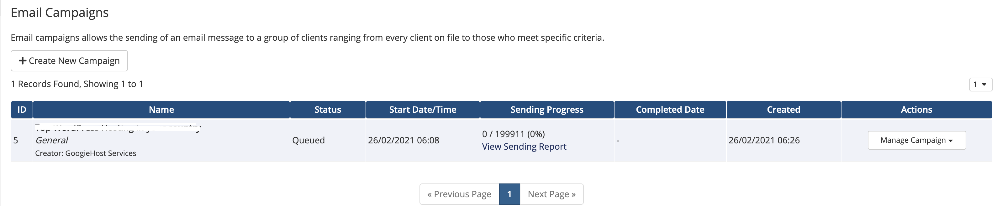

GoogieHost Posted February 27, 2021 Share Posted February 27, 2021 (edited) its been 5 days its showing same status, have checked the cron and its running just fine. I am not able to send any email marketing campaign as its showing Queued my first campaign now Edited February 27, 2021 by GoogieHost 0 Quote Link to comment Share on other sites More sharing options...
