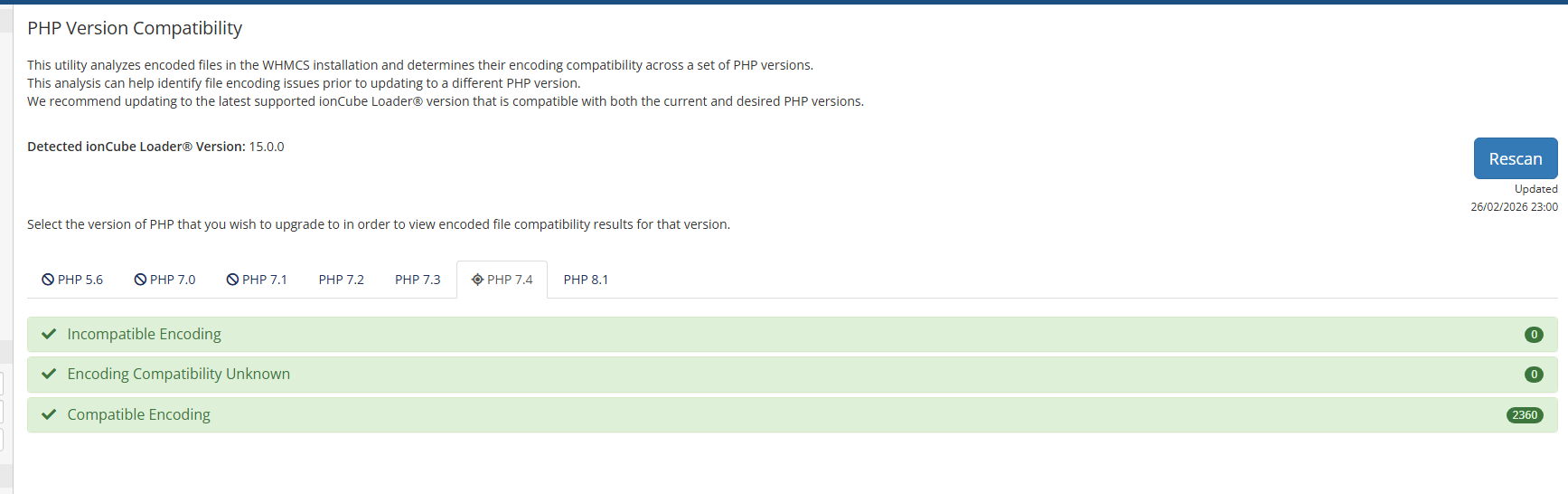

easyhosting Posted 1 hour ago Author Share Posted 1 hour ago (edited) On 1/31/2026 at 8:52 AM, wtools said: Have you checked my second question? just to make sure that there is no conflict in the php versions. website php: alt-php74 WHMCS php: 7.4.33 Configuration File (php.ini) Path /opt/alt/php74/etc Loaded Configuration File /opt/alt/php74/etc/php.ini Edited 1 hour ago by easyhosting added image 0 Quote Link to comment Share on other sites More sharing options...
bear Posted 1 hour ago Share Posted 1 hour ago /usr/bin/php uses the default *server* php version. You're using "/opt/alt". which implies the site uses a non server php instance. Have you tried looking at php info or your control panel to see what the server default php is?? 0 Quote Link to comment Share on other sites More sharing options...
