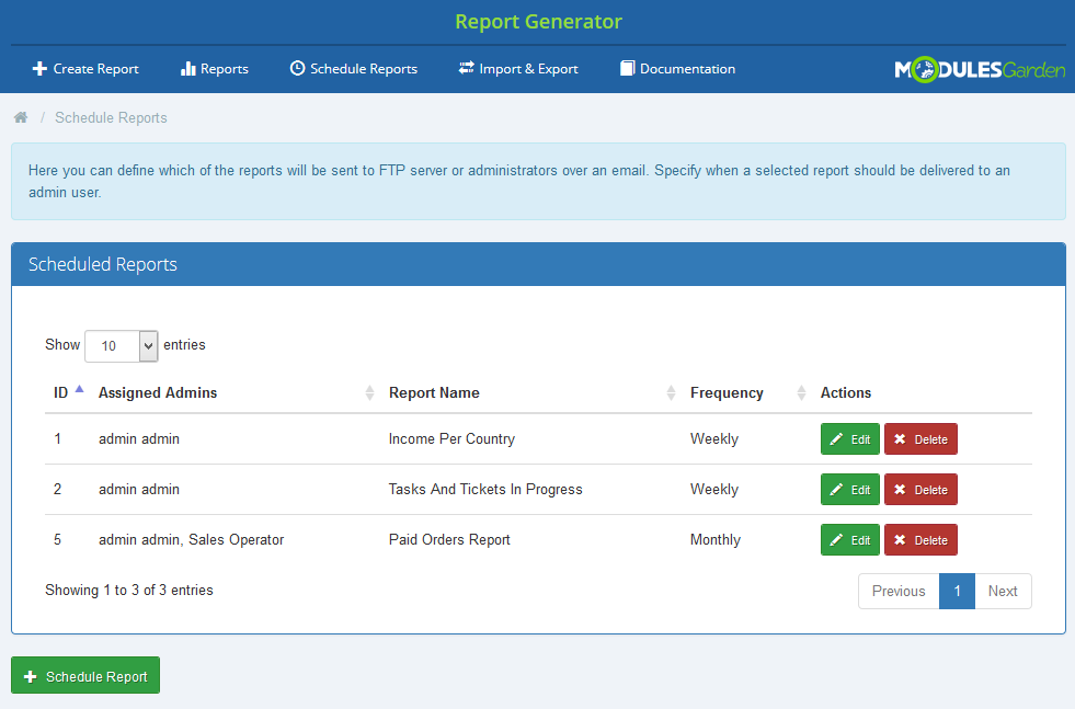

you can't schedule them from the admin area by default - the ModulesGarden Report Generator addon can generate reports and email them to chosen admins on a scheduled basis...
remember that a report is basically just a SQL query with a means of outputting the results visually - therefore a custom solution might need to be a combination of a cron job, SQL query to generate the results and SendAdminEmail API call to send the email to the selected admin(s).
I can't think of any existing module that can do this other than MG's Report Generator.
