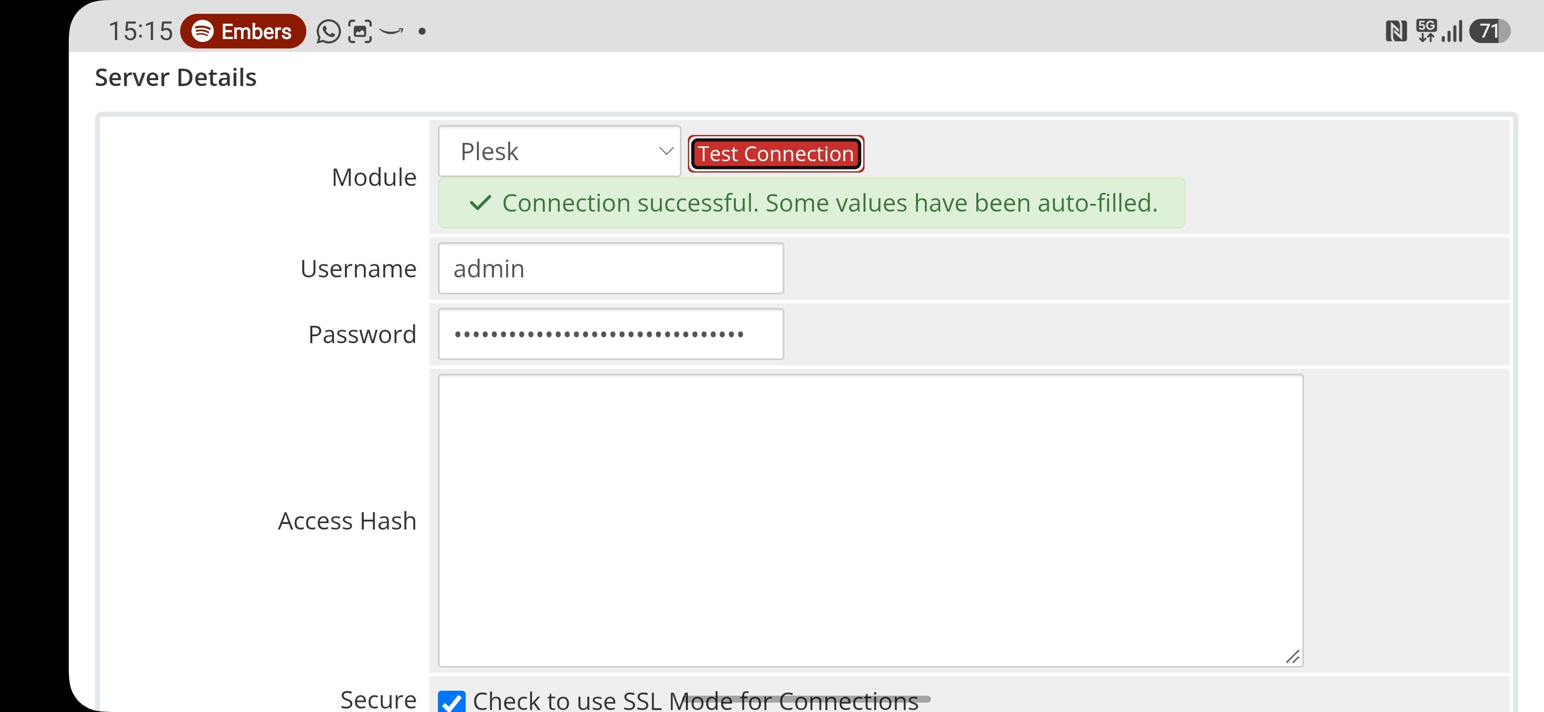

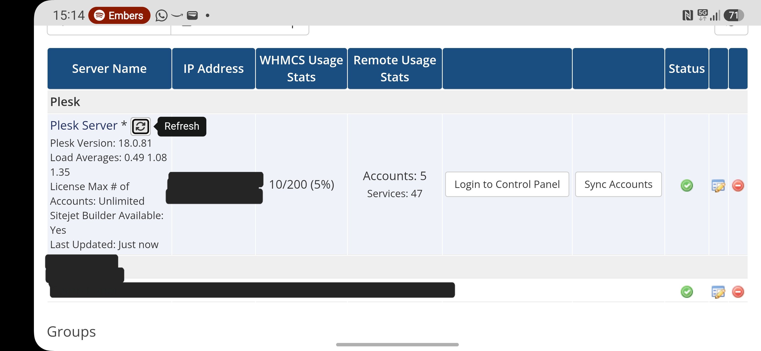

as shown in the images i posted plesk is fully up to date!!! (Plesk Obsidian 18.0.81 Update #6)
and running WHMCS version 9.0.9
