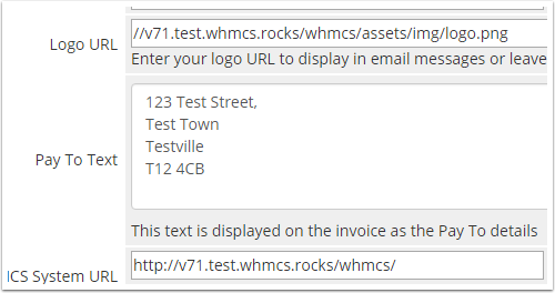

brian! Posted October 11, 2018 Share Posted October 11, 2018 7 hours ago, CJF077 said: In regards to the logo, is there anyway to have text on the right hand side, eg website / email address. Currently the invoice has only the logo and no additional contact information. the usual way to do it would be to enter those details in the Pay To box in General Settings -> General Tab and enter your postal/contact details there... http://help.whmcs.com/m/system/l/698239-change-the-pay-to-address-on-invoices ... and the invoice templates are designed to output those details aligned to the right-hand side of the logo. the other way would be to edit the template directly and add those details in there in the layout of your choice. 0 Quote Link to comment Share on other sites More sharing options...
