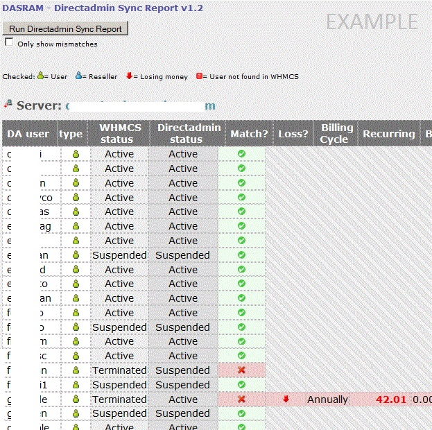

cyberneticos Posted November 13, 2010 Share Posted November 13, 2010 (edited) DASRAM v1.1 STABLE - Directadmin Sync Report Addon Module What is DASRAM? DASRAM is a WHMCS addon that provides audit reports for Directadmin accounts. It will check all admin users in all Directadmin type servers you have in your WHMCS installation. Each Directadmin user will be compared to the WHMCS user with that same username. If there is a match DASR will not show the result, unless you press the [show all results] button. If there is any type of mismatch between the Directadmin and WHMCS users DASR will show the result, what aspect did not match and will advise if this situation could be a potential money loser for your company. Current Features: -Checks every Directadmin user on every Directadmin type server in WHMCS automatically -Checks if user exists in WHMCS and its hosting package status -Compares both Directadmin user status and WHMCS package status -Will alert you if there is a mismatch with any user and level of mismatch -If mismatch will tell you potential money loss for this status -If potential money loss detected, will show projected amount of loss -Will report total monthly recurring potential money loss for every Directadmin servers -Sends email reports with mismatched users and potential money loss for every server -Added debugging functionality Tested on WHMCS 4.3.1 and Directadmin 1.36.2 (should work for future versions without modification) --------------------------------------------------------------------------------------------------------------------------- Free DEMO: https://www.cyberneticos.com/clientes/dl.php?type=d&id=16 (full features but limits to 10 accounts per server) Buy full version: https://www.cyberneticos.com/clientes/cart.php?a=add&pid=336 (Price: 29 EUR Lifetime, no license required) --------------------------------------------------------------------------------------------------------------------------- Very easy to install and configure in less than 5 minutes. Enjoy! Edited November 13, 2010 by cyberneticos 0 Quote Link to comment Share on other sites More sharing options...
